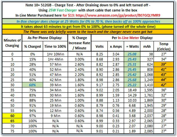

Yes only what is going into the phone. Here is a test I did with real-world results. The online meter is very cheap. Please do this with the other charger you are mentioning, it will take you about an hour to do each, then pay the results here, thank you.

When I first did the below test I had what I thought was a great cable - but the on-line meter is SO GREAT for seeing this - you CANNOT go by looks alone for any cable I guess :-(

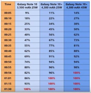

This is fantastic! Thank you. Can you do the same test with the 45w Samsung charger when it's available? It would be really beneficial to know the same info with 45w charging.
I will do my own version of the test again for the 45W charger when I get it too... May I ask however, what is the last column in your chart because the header of the column is chopped off. Is that the Note 10+ 5G version? And is there any difference with the charging for the 5G vs. Non-5G Note 10+ ? And from where were those numbers obtained (see my chart that was a test I did myself) - ? Thank you in advance for your response...

I reposted the chart. The last column was the Note 10+ @45w. It came from the video in the link. Your test was really good because it shows rate of charging and temps. I'm looking forward to seeing the results of your testing of the 45w charger. Temperatures will be interesting to see. I am curious if the temps go higher on the 45w vs the 25w charger or the same temps.
45W chargers according to the standard charge by 15Vx3A=45W. The Note 10+ can handle only a maximum of 10Vx4.5A=45W, the way the Samsung custom 45W custom chargers work. Therefore your charger (which although 45W, is not Samsung) is only charging at (the maximum voltage the Note 10+ will take, which is 10V - look in ABOUT in your settings menu!), (and the maximum amperage your charger will output, which is probably 3A), so your highest wattage for the charging in your case would most likely be 30W (=10Vx3A). You should buy an in-line meter like I did and then you can see what is really going on. Try different cables too, the only cables guaranteed to work are those that are USB 3.1 Gen2 (5A) cables, which have USB Type-C connectors at each end (even a lousy adapter for the connector will sometimes disrupt the more complicated connection between the 45W power supply and the phone): https://www.amazon.com/gp/product/B...ag=hawk-future-20&ascsubtag=UUacUvbUpU6625387
