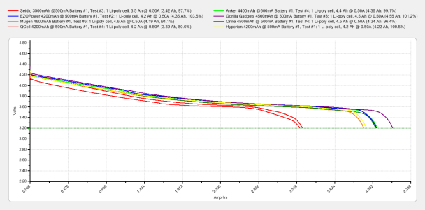

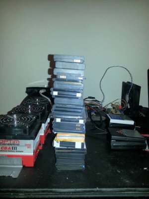

After being scammed by QCell using short batteries and plastic shims to fill in the space, I bought 2 battery analyzers (CBA-III & CBA-IV) and a bunch of extended batteries and tested them. I wanted to answer the question, "What makes Mugen's $88 battery so special?" Well, let's start off with a look at the results:
ezopower anker hyperion onite gorilla gadgets mugen seidio qcell composite.png
Nothing special about the Mugen battery, it tested at 4190mAh, 91% of advertised capacity. Notice how other batteries surpass their advertised rating, and some much cheaper batteries outperform Mugen. Let's take a look at the inside of the Mugen battery:

That writing too says SWB495060AR/12F25001 +4.35V. There has to be more to the story than just the numbers being the same, because the Gorilla Gadgets has the same thing, but has significantly more capacity. More details on all that are scant at best.
I had that same question... What makes Mugen so special? I hope I've answered it!

The mugen battery is only 4200mah and ridiculously overpriced. I bought tested, and reviewed the battery. The back case is disappointingly shoddy for the price. If you want a cool case, try the seidio one... but you'll have to call them up and order a "replacement"

I bought the battery directly from Mugen's website, and used a transparent, unbiased, calibrated, repeatable, minimal variable test to analyze the battery, along with opening it up and showing it had the markings of a lesser capacity battery, and performs like one too.
My tests are more accurate than any other methods used for testing, and the physical evidence is undeniable. It only seems fair that if you're trying to rebut my analysis with somebody else's test results, that they match the requirements you put forth for mine and be the average of a 50 sample set.
Being blamed for a poor test result, or told that it was merely an anomaly or defective product with company x's battery is nothing new to me. Illogical arguments are used in the defense of company x, and impractical requests or demands are made, among other things.
If there is a result that doesn't make sense at all, I would consider that the product is defective, but my experience says the result here is not because of a defective battery.
