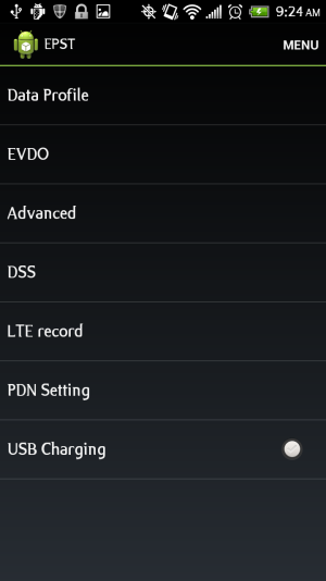

1. Find your MSL. Download MSL Reader from the Play Store. Run it, and let it do its thing. The last number it gives is your MSL. Mine, for example, is 125392.

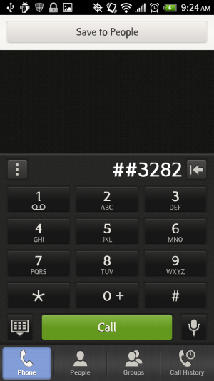

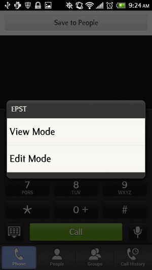

2. Open your dialer. Dial ##3282#.
3. Select Edit Mode.

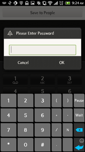

4. Enter your MSL number you obtained by using MSL Reader app.

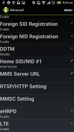

5. Click on Advanced.
6. Scroll down until you see "RTSP/HTTP Setting" and select it.

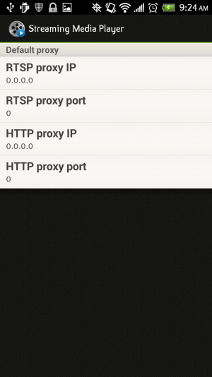

7. You will see RTSP proxy IP, RTSP proxy port, HTTP proxy IP, and HTTP proxy port. These will be filled with data - write down the values if you wish, if not, no harm done. Editing this will not affect your phone's operation. All this is doing is bypassing Sprint's proxy - essentially we are cutting out the middleman to reduce lag. They're already pushing data the size of a watermelon through a network tube the diameter of a golf ball.....let's improve that.
8. Fill in the values as follows and then hit the back button on your phone twice to go back to the "main" menu.
a) RTSP proxy IP: 0.0.0.0
b) RTSP proxy port: 0
c) HTTP proxy IP: 0.0.0.0
d) HTTP proxy port: 0

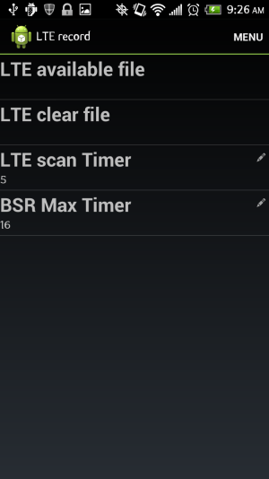

9. Now Click on LTE record.
10. Click on LTE scan Timer. Change the original value of "30" to "5".
11. Hit menu (upper right hand corner of the same screen where you changed 30 to 5.
12. Hit Commit Modifications. Let the phone do its thing. It will say rebooting in 10 seconds or hit "ok" for manual reboot. Either way, just reboot your phone.

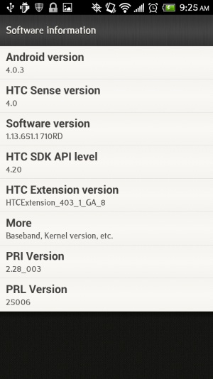

1. Update your PRL. I'm using 25006. There are a few FAQs floating around on how to do that, I'm sure.

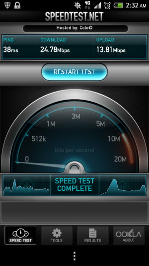

I'm curious to see if this works in other markets....meaning, did I get lucky and it actually DID work? Or did Sprint finally finish up work on their towers in ATL, and the'yre beginning to push out some good signals? ..................time will tell........
I've also heard that reducing LTE scan time can eat at your battery. However, it only scans when you're NOT connected to LTE, from what I understand.....and further, I haven't noticed a difference in my battery life. I'm rooted and control my CPU, so any would be battery life issues are compensated for by lowering the CPU speed when the phone is off, less than 20% battery life, etc. etc.
I still haven't figured out WHY this 'hack' works exactly, but after doing this I've been on LTE at least 85% of the time during my twelve hour shift just driving around.....up from maybe 10% prior. It just seems to help the phone stay hooked on LTE longer. I know many people have had problems where the phone goes 4g and then right back into 3g.

Is the LTE scan timer seconds or minutes?
I have not changed mine but i went to lunch in an area that i know for sure has LTE. I had to put my phone in airplane mode then back to normal for LTE to work.
I have not made the changes but if its minutes that makes sense as i was there long enough to park my truck, wait in line for my food and get half way done before i realized i was on 3G still.
And FYI, i have been using a GS3 and eat there several times a week and every time i have been there my GS3 is on 4G. So seems the GS3 does make the switch faster.
If the timer is in seconds i dont want to mess with it but if its in minutes going from 30 to 5 to me makes sense.. But i wanted to see if anybody knew for sure..
thanks
Sorry for the delay - Work has been keeping me insanely busy. Rooting did not mess up my phone....but it CAN if you do something stupid while its in the process of rooting (ie unlugging it.) I used Panda to root and decided to go with s-off. It works like a champ. I then installed TWRP and flashed MeanRomICS. There are threads all over these boards to do it. Start to finish it shouldn't take you more than an hour, having never done it.
The LTE timer, from my understanding, is in minutes. There is also a weird issue with the HTC 4g LTE where cycling through Airplane mode (turn it on, then turn it off manually) will give you 4g. Meaning your phone didn't recognize there was 4g around you even though there was. The Evo LTE has a pretty high threshold and seems to have an issue finding the signal.

I did this and it seems like there might be a slight improvement, it seems like I have NO data more often, or it'll be off when I turn the screen on, but after a few seconds it comes back on. Is there anyway to go back to default if I decide to? Like an idiot, I didn't write down what it was before.
Thanks.
Here you go Husker Z
RTSP Proxy ID
rtsp.vog.sprintpcs.com
RTSP proxy port
554
HTTP Proxy IP
pd.vog.sprintpcs.com
HTTP proxy port
8085

Does changing the proxys relay work I only changed the timer

Also does anyone know what the BSR max timer is, it is originally set at 16
