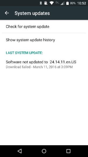

I'm having a problem. Marshmallow failed to download. And I can't seem to redownload. I search for update and it says my phone is already updated but clearly says it's not haha. Can I go somewhere and download it?

Have you tried Verizon's Software assistant from a PC? That is how I finally got my T2 to get Marshmallow.
Read back a few pages/posts and you will find what you need from those who have already been through this . . .
Just be aware if you do this and your phone has a custom startup message, using Software Update Assistant may overwrite the custom message with no way to get it back. See http://forums.androidcentral.com/mo...ate-has-happened-anyone-else.html#post5098891
Since we're having this discussion, my turbo 2 still says I'm on current software (5.1.1) are we still in the "rolling out in stages" phase?
No, doesn't seem that way. It's out there for weeks now. Just seems that the upgrade process is flakey. You might have to jump through some hoops, but you can get the upgrade now via the Verizon Software Upgrade Assistant.
