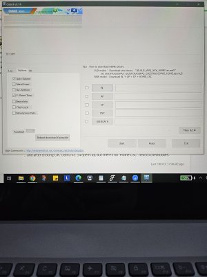

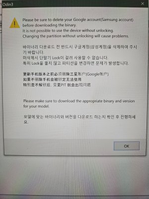

. . after I unzipped "Odin v3.14.1.zip (latest stable release)" . . I got this weird pop-up:
20240310_174900.jpg 🤔
. . and after clicking OK, Odin3 v3. 14 opens up, but there's no "Home CSC" next to checkboxes.20240310_175949.jpg

So Odin extract was good
Frija you download the firmware file to your computer and did you extract it?
