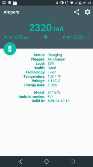

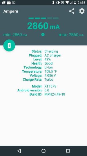

Not with my Moto X.
Here's 20 mins of charging.
Posted via the Android Central App on the Moto X Pure Edition

Initial.

10 mins later.

20 mins later.
