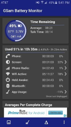

First of all, why is app usage negative? These percentages don't make 100... Second of all, why did WiFi use so much battery?!

I've seen that before with GSAM, clearly a bug, I'd suggest you to clear GSAM Cache and App data and give it a couple of new battery charges to leave it to get set again.

My WiFi has started to use around 35% of my battery per charge, even though it is off for like 7 hours a day. Where it says WiFi active, does extreme WiFi use make that percentage increase? Or is there a but?
Do a Wipe Cache Partition in Recovery mode, then put it to charge to 100%. Are you using a 5ghz or 2.4 ghz wifi connection? If you have a 5ghz connection and doing the Wipe cache doesn't help, then try removing the 5ghz connection and connect to the 2.4 ghz one.

Doing a cache wipe kinda helped it, but it still uses a lot. It might just be a lollipop bug though.
