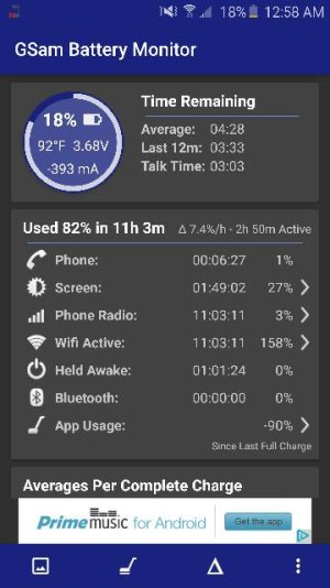

At this point I only had 1:50 of screen time, what happened?!
Your guess is as good as ours, try posting more screenshot from GSAM and I'd take a look at the default Battery stats from the phone, something should appears more clearly there.

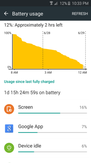

This is my last night stats, this should be my best all around battery performance (SoT and Stand By combined) in a very long time, second only to the undisputed battery champion, Sony Xperia Z3.
It was unplugged Saturday at around 7:00am and literally lasted all weekend, No power saving modes, only thing different is that I didn't turn on Bluetooth at all, I was sick at home and didn't use my Smartwatch.
View attachment 184071 View attachment 184072
Hope you feel better. You may want to edit your original post to include the "ANT" tweaks.
Feeling a little better, thanks.
I added the ANT tweaks to the OP last week after I did the changes on my phone.

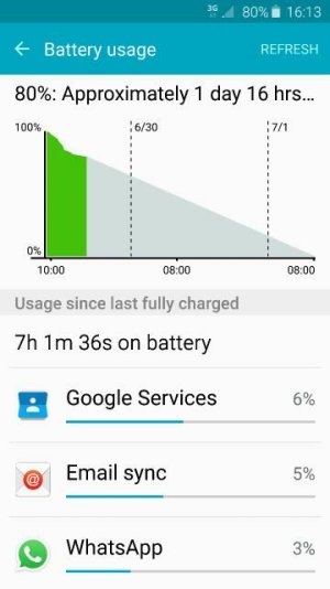

Man Erasat salute! This finally did it! Did safe mode as you suggested and have all the original apps running 🏃 except for fb resident app.. A.I type keyboard and cleanmaster.. Here is the screen shot see for your self. Earlier was charging the phone 📱 three times a day!
That was my suggestion courtesy of Samsung lol. I'm glad it worked for you. It helped me find out what the rogue apps were too.
What I did was gradually reinstall apps to see which made a difference to battery life and which ones I could have on my phone without making a difference
