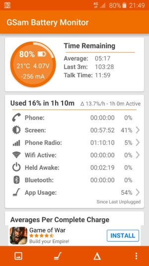

Lol last three minutes 103 hours. It actually at one point said 150 lol. Wow standby time seems to be so much better on 5.1.1

Forgot to attach the picture lol
If you did what I suggested in the other thread, about the auto stop the apps, yes, it seems to help on standby, but again, have you installed the apps I suggested you for checking the Network connection? I'm curious to see if the new Indian firmware helps you with your radio issues, that also will greatly help you in standby mode.

I am curious though to see what the closing of the apps after ten minutes does to my standby battery life though. That makes it all worth it
The concept is quite simple and good, no matter why the app was open, because of you opening it or running in the background for some reason, after 10 minutes it will "force close" it, thus preventing them to keep running in the background as they normally do.

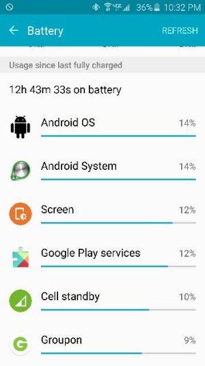

Sorry if this has been addressed already. Is anyone have an issue with their android system and android os using most of their battery life?
