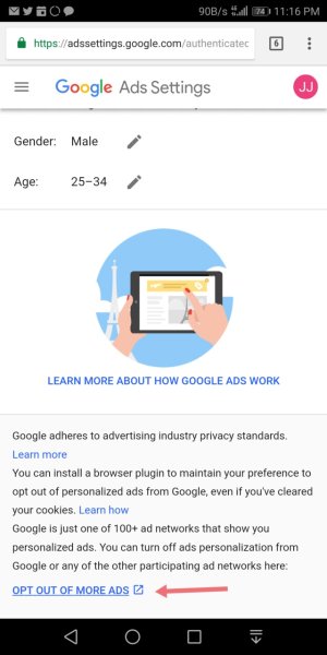

I have a Samsung 7 with the same ads popping up which are from Google AdSense. Log on to your Google account and click on add settings, then turn off ad personalization, then click on AdSense and follow to opt out of all third-party ads and do it multiple times in the end leaving you only with one company they won't let you remove that but at least you will have all the other hundred plus companies that will no longer advertise for a while as you'll have to do this overtime every once in awhile as a will keep adding third-party companies overtime. The only other option is to get rid of Google on your phone.
