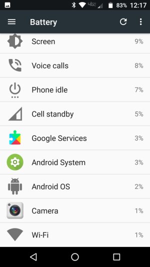

Go to Settings, Battery, see what is using your power. Since you have a new lithium battery, don't drain it to zero. Old nicads are able to be refreshed, so to speak, but not lithium which can be damaged permanently by continuing to fully discharge it.

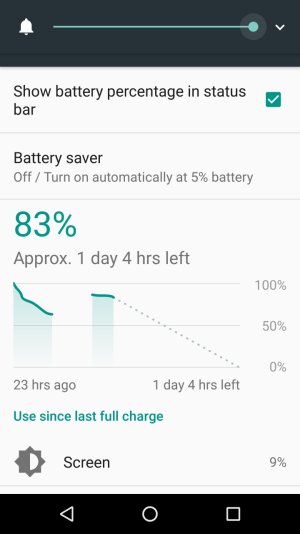

I charged it with the power off last night and used a different charger it showed 100% then when unplugged and turned on it dropped down to 85% and is doing pretty good, but still don't like the drop down and am at home when I go out I will be using data, pictures etc. When I started charging last night it was about 64%. Also more clarification on to discharge or don't discharge this new battery because seems like some disagreement on that solution. Here are screen shots
just googled discharging lithium ion batteries says not too at least over and over, should charge when reaches about 50%. Don't know if one time would hurt it . . .
Do not discharge any lithium ion completely unless it's accidently done. Not even once. You will certainly worsen your battery life further.
