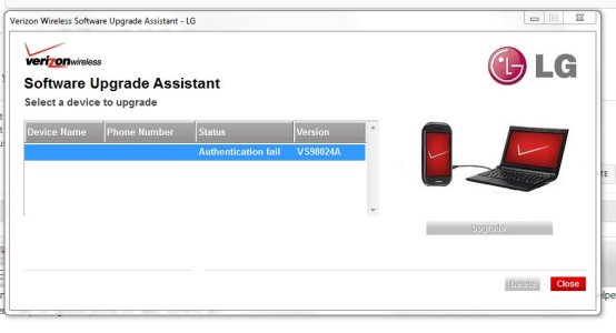

Completely stock. Tried reset within Android and via Boot mode. Also found that for whatever reason, LG has a different set of drivers for the white model. Not that it helped now. Also tried FW Update via download mode (powered off, hold vol up and plug in cable)Capture.JPG where computer finally recognized phone but failed authentication.
