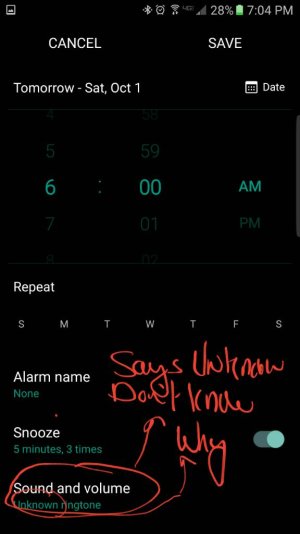

Anyone else having an issue with the Alarm clock suddenly not sounding?
I cannot figure out why this is.
It was fine last week. And for no apparent reason it's not making any sounds. At all.
When I open it up the sounds say "unnamed and unknown".
I use Google Now when setting up. Until the last two days it worked perfectly fine.
I'm stumped.
I'm stumped.

I just say "Ok Google" and then "set alarm for _____" and until 2 days ago was never an issue.
Two photos. One of command. One of the actual alarm screen.
Also I always have my Gear Fit 2 on when sleeping and it does vibrate when alarm goes off but it's always done that with the Alarm going off as well with sound.
I just mute the phone when I go to bed but it still vibrates. Would that cause it? How do you make exceptions for it?

It's strange. All of this is already set properly. I double and triple checked.
When I use my clock on my own and set it up no issues.
When I ask Google to set the alarm it doesn't make a sound. I went and looked at the alarm info once asking Google. Under Sounds it says "unknown". It's never done that before.
Check your ringtones. I get that when I delete the ringtone that the alarm app is using. If you change the ringtone for the alarm I think it will work again.
