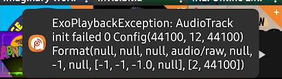

This seems to be a system related issue as I'm getting a few seemingly related error messages.
This one is from Podcast addict.
Trying to change to any ringtone, even preinstalled ringtones shows.
"Sorry, the player does not support this type of audio file."
