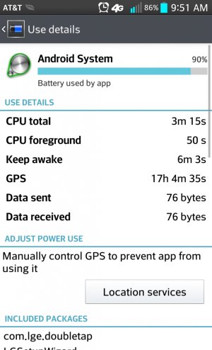

So I did a 4.2.2 software update of my AT&T LG G2.
I'm having Android System consuming unusually high battery (90%). See the attached screenshots. I go inside the Android System and see that GPS is running non-stop. I'm still getting a decent battery back up thou. But I'm just thinking why is the GPS always running despite it being turned off.

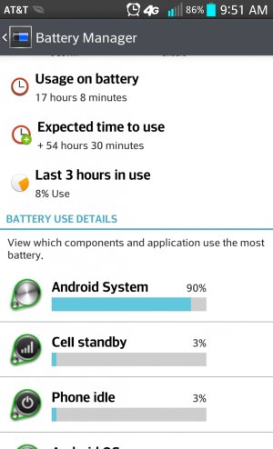

If I am reading that correctly (I have never seen this type of screen before; I am used to Android's battery stats) your device has been unplugged for 17 hours and you have 86% left? That is a lot of idle use. Basically all it is saying is the 90% of the 14%. In other words, 12% of your battery is used by Android. This happens when devices sit idle. Something has to account for your battery drain, and in this case it is Android, because the OS is always running.

Yes. That is exactly what it is. The phone was charged by 5PM yesterday evening and, it stayed idle pretty much all night except few calls and 20-25 texts. The screen shot is of the built-in LG G2 battery meter app. My daily usage of smartphone is something like this.. 30-45 min of calls, 2 continuously synced email accounts, 1 continuously running internet based text application and occasional browsing. With good signal, I usually get about 80 hrs battery life. I usually charge once in 3 days.

I guess my question is why does it show that GPS is running for 17 hrs 4m 35 sec? Basically all the time phone is running, it shows GPS is running despite GPS being turned off. Any idea why?
