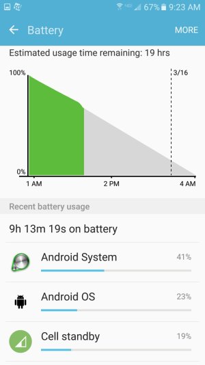

motivr's screenshot is a good example. 9 hours of what is basically straight idle. Nothing happened, from what we can see, except idling. But only 83% or so (estimated) of the total 33% that's been used (estimated) is accounted for, so there's still about 1/6 of the battery that's been used thus far accounted for somewhere else.

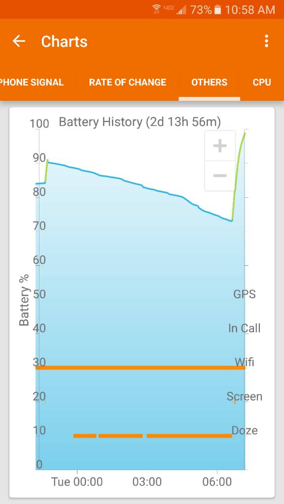

I suspect that you have a wakelock somewhere, because your WiFi is on 100% of the time on the GSAM shot and the stats show that the device is active for 3 hr 12 minutes out of 5 hr 47 minutes but the screen was only on for 1 hr 12 minutes. So that two hours could perhaps account for streaming pandora with the screen off, but if that's not the case then that's where I'm suspecting a wakelock.

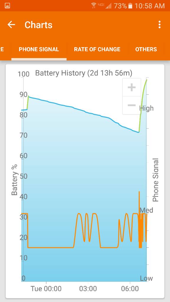

When I'm asleep it usually loses over 15% last night it dropped for 91 to 74 overnight.
mumble, grumble. :s That's disappointing.
Your stats are trending for 3 hours SOT out of 14 hours total usage compared to another user who is trending for 5 hours of SOT over a 24 hour period - so there's definitely room for improvement, we just can't do an apples to apples and say that 5 hours over 24 hours is the goal, because it might be too aggressive or not aggressive enough.
Here is the chart from last night

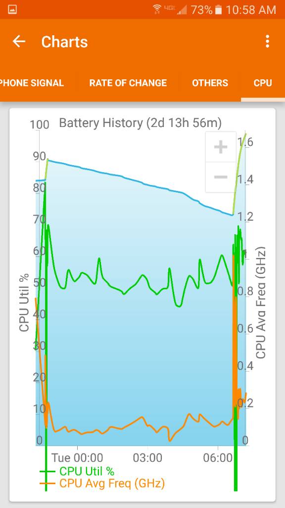

I think the better question to ask about this is how much CPU time is the system taking up? My android system use is high as well.
For example - today so far my phone has been on for 5 hours. Screen on time of 55 minutes, battery is at 80%. Android system has used the CPU total for 55 minutes as well.
The first couple of days, I was seeing near 3 hours by the end of the day of CPU usage by the Android system. What do people with 7 hours screen time get?
