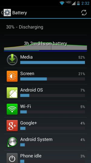

I have an app called media that is destroying my battery. It's using close to 70 percent per day whereas the screen is only using like 20 percent. I'm about to do a factory data reset and see if that changes anything. Hopefully it will.
Have you tried force stopping it? Something easy to do but maybe take your sd card out. If you have music on it, maybe it's trying to access it? I'm just throwing out a guess, but i would assume that's what media means.

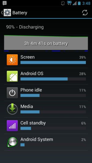

The entry for "Media" is still present though. Maybe I'm missing something but it doesn't show on mine at all under battery usage.
