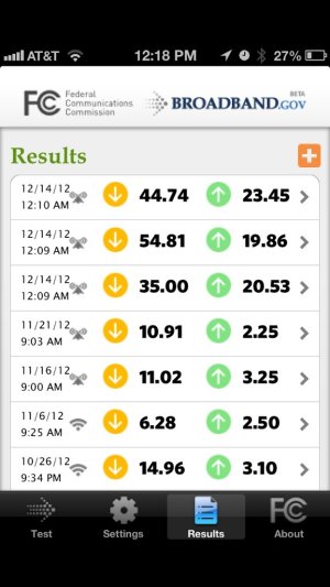

This is exactly what I am talking about I currently have the iPhone 5 I have the 10 gb share plan I will go get a micro sim and give them the imei from the nexus once it arrives yet based On other folks here they have the right plans and the still cant send messages i get decent data speeds right now where I live in Dallas I get avg 30mps on my iPhone 5 lte I know so i would expect at least 10-14 Mbps down with h+ but these stories of suck speeds and service working can't all be just wrong plans why do we have to enter all of these settings when I used the gnex I popped the sim in and the phone pulled the settings and I did not have to change a thing oh well to good to be true it just doesn't make sense that these phones would have to go through all of this like playing roulette hoping you get lucky ImageUploadedByTapatalk1355595665.157152.jpg
