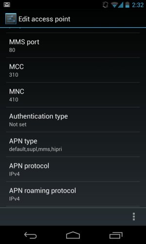

This is the APN I'm using I got it from another thread and I'm getting the same HSPA+ speeds like I was getting on my iPhone
http://forums.androidcentral.com/google-nexus-4/226874-nano-sim-adapter-2.html
Name: (whatever you want it to be)
APN: phone
Proxy:
Port:
Username:
Password:
Server:
MMSC: http://mmsc.mobile.att.net
MMS Proxy: proxy.mobile.att.net
MMS port: 80
MCC: 310
MNC: 410
Authentication type:
APN type: default,mms,supl
Your missing some of the APN type.. This is what you should have for the bottom half of the settings...

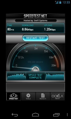

And here is the fastest I've gotten and I'm on the 4G lte plan still
