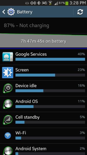

Anyone know why this is happening?
Ya this is what I was thinking. I never noticed Google services this ugh before Guru. Gonna uninstall it and see what happens.

As I mentioned above, you may want to try to get a larger sample size before making any permanent conclusions. Google Services being high doesn't *necessarily* mean that it's a problem.
Are you using it to control WiFi? My understanding is that it uses location services for that (which ironically works better with WiFi on) so if you don't have any other apps tracking your location it will be the only one and show up as "Google Services".

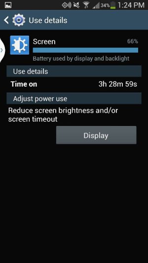

What was your screen on time though? That's what counts haha how long can you actually use your phone with the screen on. Without any battery saving apps, I get around 5 hours of screen time on an average without any charging rime between unplug and death. And that's with air view, sync, data and multiwindow enabled. Not even having the built in power saver mode turned on. Whenever I had the guru on it was down to about 3 hours so I just decided not to use anything. That's what worked for me.

I realize that screen time is the ultimate factor of interpreting battery results, but that doesn't mean that battery performance during standby isn't important as well (it certainly is to me). The only point I was making is that you notice in that screen shot that Google Services is at the top of the list, yet it wasn't having a huge effect on my battery life. That's all, it was to point out that under some conditions it can be *normal* for Google Services to be high...In the OP, those screenshots were taken after very short amounts of time off the charger, so it's really hard to gauge if that was an actual issue or completely normal behavior.
Now, that is an interesting point you make about screen time though. Just through passive observation, I feel as though my battery has been lasting longer with Battery Guru, whether it be in standby or during heavy use with a lot of screen time...but given what you've noticed, I may have to take a look at my screen time and see if it being adversely affected by that app.

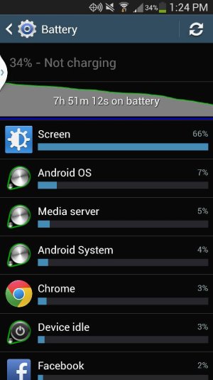

I removed battery Guru and been watching the screen just suddenly jump over Google services in consumption percentage. Also note I posted 2 screen shots in my OP. The first was fresh of the charger this morning the other half way through the day yesterday. I will post more usage shots tonight and tomorrow morning.

Well, if the screen is on it will take up a larger portion of the battery. The second screen shot in the OP is after the phone has been on for 6 minutes at 8:52AM. It would be interesting to see one later in the day with some indication of how much screen on time you had.
Was Battery Guru still learning when you removed it or had it finished with that? I'm not trying to defend Battery Guru, I'm actually interested to hear what's really going on.

I know not everyone's "day" starts the same time, but I based my comment off of the fact that it says 8:52AM and 5 minutes off the charger in that second screenshot.
Also Guru was not in learning mode anymore when those screenshots were taken.

So Google services is still using the most battery. However, since removing Battery Guru my battery is lasting longer. At this time yesterday I was at 67% battery life. Today look at it. Basically the same amount of usage.
