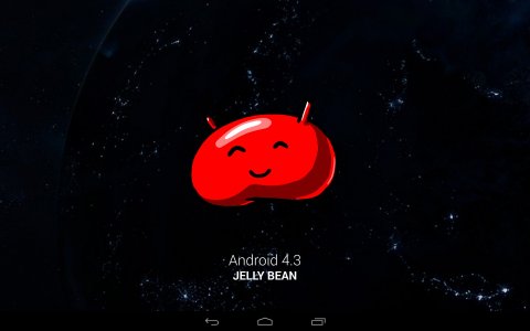

android4.3 is pretty good
however, some apps will force close
