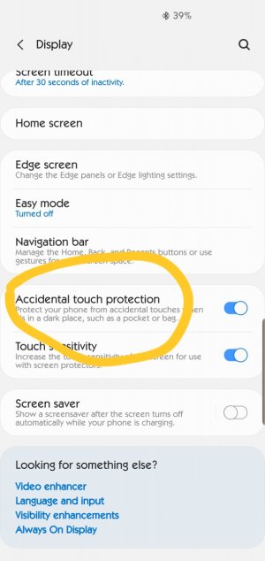

Try toggling this switch on and off. Its found in the display settings.
Didn't work. AOD only dims when the phone is laying on its face or in a pocket, it doesn't shut off completely whether that setting is switched on or off. Strange... my Note 9 on OneUI does still shut-off completely in those situations.
