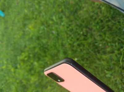

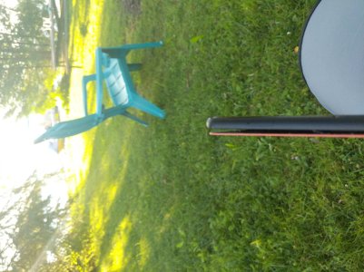

The back glass on my Pixel 4xl is peeling. I noticed it in April when I randomly took my phone out of its case. I wish I didn't have this problem.
The Google store support refuses to do anything about this. I'm incredibly disappointed with them.
It is unclear if it is due to the battery swelling or the glue just giving out.15955456928493614040816020395889.jpg1595545556510458254291477953448.jpg

I'm sorry to hear you have one of those units, try again talk with different person until someone does something about it .
