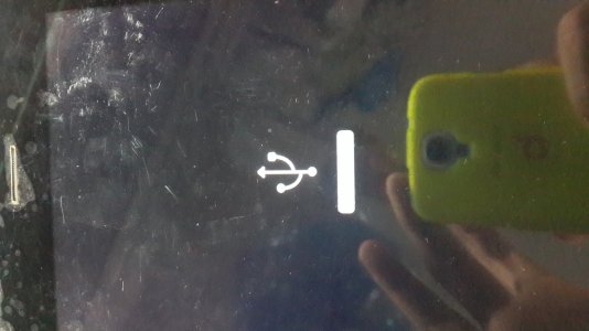

I have ASUS fonepad K004. It's all show USB logo 20150319_190322.jpg. I try to reset by press Volume up + Power key but still nothing work. But when i plug the usb cable driver found on pc. How can i fix this problem? Please help me
Thanks all i be waiting
