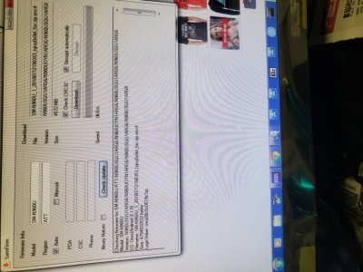

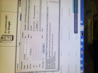

It is according to samfirm that's the latest this program connect to Samsung servers any ota come to device go to that
Samfirm you will not see any att odin , so we go behind them and get att odins from other place 1ARG9 is crazy old patch .
AT&T doesn't make their firmware images available on SamFirm generally. For some reason, an ancient version exists on SamFirm, but it's nowhere close to current. ARJA is the current revision and is November patch. No Odin has been found for it yet, but an ARJ7 Odin image exists which is October patch.
Venom will have the ARJA Odin files when they become available. For now, just use ARJ7 and use an update zip to get where you want to go.
I'm looking at 2 other places dont show update for att on November
Sammbile
Samfirm
Updato
Non have it
