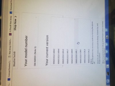

Screen shot

Oh ok thanks for the quick reply! By the way, can I flash the ARL1 file the same way through SD card?
When I click on my current version (ARK5), the only update that is available is CRL9 though.
