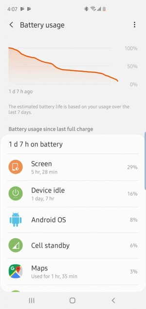

He's a screen shot of my battery. Unplugged around 9am yesterday made it to 4:00pm today before it hit 10%
