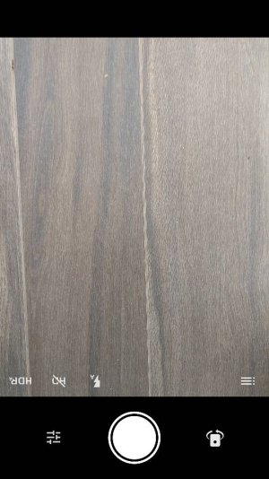

Hi, I received my OP3 on Thursday and I've enjoyed using it. But I noticed really odd behavior in the camera - taking photos upside down and the settings menus being at the bottom of the screen and upside down. Then, I noticed in general that the auto-rotate was really sketchy.

Yes, I cleared the cache and all that. I also did a factory data reset. It seems really odd that the camera menus are upside down the first time I open the camera app after resetting.
