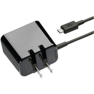

The 1.8A Blackberry Blade charger works on my GS3 and the 6ft long cord is a great thing!!!
