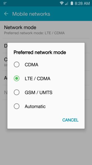

I'm concerned about the new GS6 I picked up on Friday from Best Buy.
First off, my old GS3 was able to connect fine to 4G data and had great signal strength.
Reason why I'm asking is because when I turned on this new phone and saw the booting up graphic, it says "Sprint Spark."
I'm also only getting around one or two bars of cell strength when my old phone had plenty. I went to two different Sprint stores and Best Buy to talk about the issue. Best Buy said that updating the PRL and profile (which I've done numerous times) and to leave my old phone turned off for this one to fully activate. By the way, I live in a major metropolitan area which should have great signal strength.
One of the Sprint reps said that if the low signal strength continues to exchange it for a new one. When I went to the other Sprint store, the reps there said basically there wasn't anything wrong with the phone and that data was working fine.
Am I just overreacting or is my phone defective and I should go back to Best Buy and get it replaced?
And could someone explain Sprint Spark and whether or not the "network mode" on this phone matters?

I did try changing the network mode to CDMA and I lost 4G capabilities with it. It was only giving me 3G data, but cell signal was very strong. One of the Sprint reps said to not change it to CDMA only for that reason. I have it currently on the LTE/CDMA option. When it was originally activated, it was set to "Automatic."

Yes leave your phone on lte CDMA mode. And I can tell you first hand that you cannot always go by the signal indicator, reason being is that where I live my phone shows all the bars of signal and I get 10 mbps to 13 mbps of data speeds,where I work I show 2-3 bars and I get 20+ mbps download speeds. It really depends on the tower you are pinging off and whether or not they have completed the upgrades on those towers. Where I live I am getting 4g lte and where I work it is sprint spark. Average speeds for sprint 4g lte is between 8 and 12 mbps and on spark it is 20 mbps and higher, I have got as much as 60 mbps with only one bar of signal showing. As long as your phone is working well, no dropped calls, texts go through with no problem ect, ect I really would not worry about it. Keep in mind we are on sprint network lol.

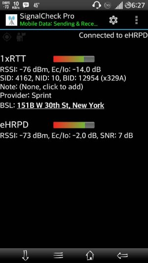

Your phone is fine. The signal bar you're seeing is most likely the weaker LTE representation which is just fine.
If you use an app like Signal Check Pro, it'll show you the SNR (represented in +/- values) of all the RF's (1x, 3G, LTE) and you'll see that your 1x and 3G are usually stronger than LTE.
When in a strong Spark area, LTE signal is more stronger.

As far as network mode, leave it on automatic unless you don't travel far and away from Sprint towers. Automatic switches from LTE/CDMA to GSM when needed, especially when roaming or in fringe areas....the idea is so that you don't drop calls. If you leave it on LTE/CDMA and travel into roaming territory, you'll drop a call faster than a High School freshman wide receiver.

I do use Signal Check Pro. Here's what it looks like when I'm at home connected to LTE.
This is from the first level of my house. If I go to the second level (the attic), I somehow get it up to 3 bars.
//images.tapatalk-cdn.com/15/04/26/2f3acb916cc554b681e5fbf1fa66b860.jpg
