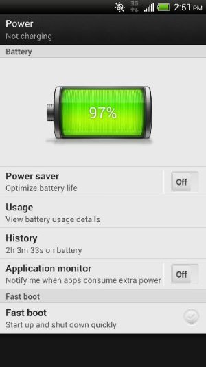

If you have not done so already, TURN OFF FASTBOOT then reboot the phone.
Yeah, I never leave fastboot checked. I don't know what it is. I have tried many things, and the battery drop is still much faster than before the update. I was getting around 14-15 hours on a charge before the update. When I first got the phone, around 19 hours. Right now, I have optimizer unchecked, I just this morning turned battery saver off, GPS off, and in Google Now I only have weather turned on.
It is a way to quickly start/stop the phone but without doing a real/full reboot. It caches stuff and pulls things back into memory more quickly. The problem is that people who are having problems and think they are rebooting really are not and some problems can persist through a fastboot. I think HTC made it default ON which is horrible from a support standpoint. Since these newer phones with newer versions of Android boot so quickly now, I don't think the option should even be offered anymore (more negative than positive) or at least the default should be OFF.

LOL, thank you, I meant, I do know what fastboot is and I never have it checked/on, but I just don't know what is causing the drain. I don't feel like doing a factory reset and having to set everything back up. Usage says my camera is using anywhere from 27% to 33% of my phones energy. Does anyone know if I clear out the data and cache of the Camera app in the Apps section, if it will mess up the camera functions?
I think they did change the default to off this go around.

I've done 5 total factory resets 2 of which I wiped the cache partition to try to fix my proximity sensor issues and each time the fast boot was checked off....so I think that's a good sign =).
