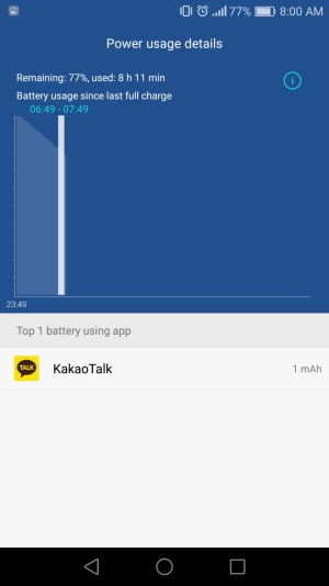

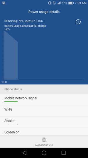

OP, please post a screenshot of your battery usage over the course of a 24-hour period; after it was initially charged to 100%. This will help us better pinpoint any possible battery issues. Thank you!
Screenshot_2017-01-10-07-59-00.jpgScreenshot_2017-01-10-07-59-43.jpgScreenshot_2017-01-10-08-00-42.jpg
Okay, so these are the screenshots I got this morning.
The phone was 100% at 12, and 77~78 at 8am.
Wifi, data, bluetooth and gps were all turned off, although I've noticed that Mobile Network Signal had a green bar making me think that was on for some reason??
The one app that's still on Kakao Talk, is my messenger app, but it used 1 mAh, which is like.. 1/3000 of the battery?
So, based on the data, I think Phone IDle and Cell Standby is taking most of the battery for some reason, which I don't think is normal.
