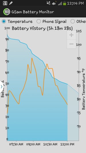

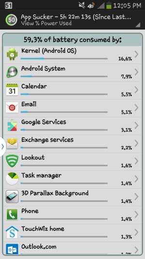

I have attached some screen shots and would like to get some advice from the Group.

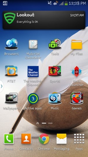

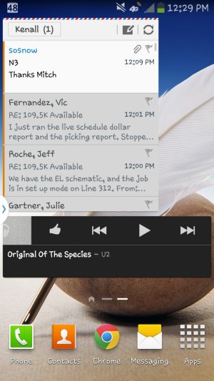

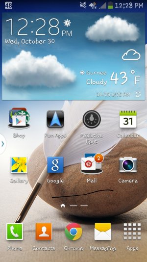

I have 3 screens on my phone(see attached pics)
I do not have facebook app or running through a website.
Screen brightness is at 3/4

Check your Google Now settings. They constantly check things in the background if not configured otherwise. Also feel free to delete Lookout unless you use it for something other than antivirus.
That's better battery then an iPhone. I have the iPhone 1-5 and the HTC one. Now the note 3 not one of those phones compared. And the fact that you're averaging 10% an hour with use is good. Btw if the background you're using is 3D and moves your using the processor and gpu that right there is a battery killer. Also look out uses battery.

It's your signal. From the screenshots you provided, your signal is very low in nearly each of them. Poor cell signal is a huge battery drain, because your phone is constantly searching for a signal. At a previous job I worked at it, I got really poor cell reception and my battery would drain like crazy, I would just put it on airplane mode while I'm at work.
I was going to post that also. Looks like your phone is looking for signal and switched between hspa and LTE, which drains battery just like having WiFi on and it keeps searching for wifi
