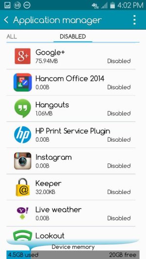

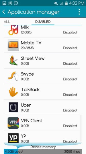

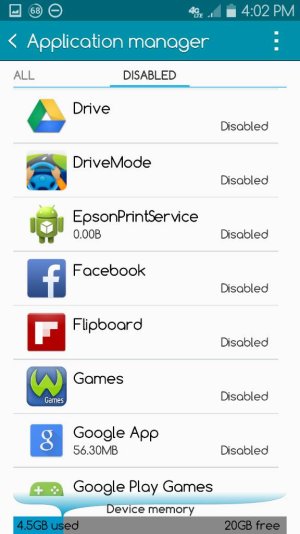

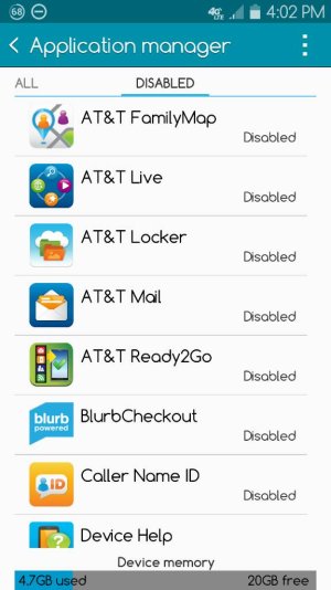

Have you disabled the AT&T bloat? I always do and am very satisfied with the battery life:

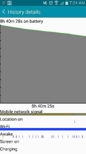

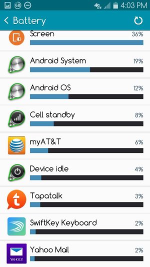

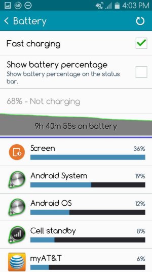

Now look at it..better but still shouldn't drain this bad while I'm sleeping
Yeah something is not right. I would say you either 1)take it back to the carrier and get them to swap the battery and/or 2)do a factory reset and see if it helps.
It's not likely, but there is a chance you have a bad battery.
