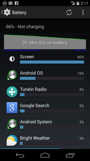

Tested it today. I ran a power hungry app for wifi tethering, but these results seem the same as what I was getting when running it before on 4.4.2.
Android system is only 3%...that doesn't seem awful to me.

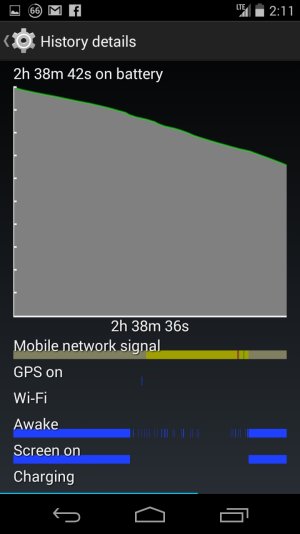

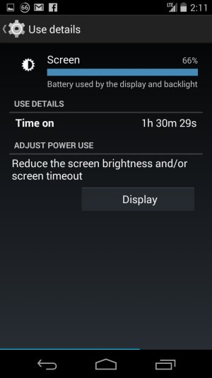

Edit: screenshots. I unplug my phone at 6:20am every day (alarm goes off). I don't even use the phone until after 8am, as I'm showering / driving to work / etc. It is 1:20pm here now, so the phone has been 7 hours and I'm at half battery. Without using it very much at all.... it sits on my desk while I am at work.
