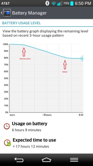

Welp, looks like I experienced it again today, post disabling Carrier IQ. A reboot cleared up the issue as before.
I attached a screenshot that I think illustrates this nicely. During the first hour off the charger you see a pretty flat line, with a loss of about 1-2%. Then something hits just past the 1 hour mark that causes a loss of about 20% over 3 hours. Then after the reboot it flat lines again for the next 1.5 hours. During that 3 hour drain I barely used the phone, as the level line should show.
Back to the drawing board.

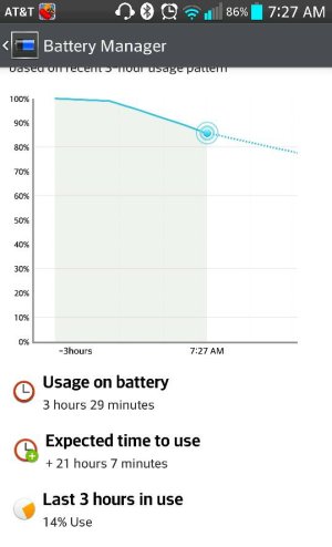

I don't understand what up with this.yesterday I restarted after some average battery life. Plugged in overnight, and now I have this amazing battery life (20 min screen, mostly Wi-Fi some 4g:

The problem for me is that I did the exact same thing yesterday, and was down to about 89%.

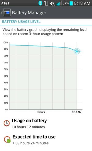

Yup. I don't get it. Last week for me all the same settings. And this was all idle.

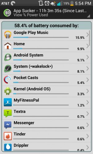

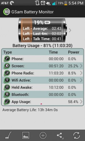

Yeah, I don't know which is worse, while you and some others lack reliable consistency with battery life, I have had my G2 for a few weeks and never gotten more than 14 hours of battery life under any circumstances.

I've never had that low. Can you post battery stats?
I posted a battery stat screenshot yesterday, somewhere in the middle of page two of this thread. I don't have newer ones at the moment, but i'll re-post those two below. To note: while only for one day's usage, these are incredibly typical and this is on the my second G2. I had my first one replaced for identical battery issues.
View attachment 85237View attachment 85238
Go into your phone radio, what numbers are you getting? Also, streaming music will obviously cause some battery drain. What is pocket casts? Also, do you have Google location services off?
That was a screen shot from the other day, so when my battery gets low today ill look into the phone radio section and let you know. I had a few other screen shots i just glanced at and google music was used for 23 minutes. Pocket Casts is a podcast streaming app, I used that for about an hour that day.
While obviously i know that streaming is going to take a chunk out of battery, im pretty sure that isn't the primary issue here. Given essentially identical usage patterns this is phone is getting noticeably worse battery life than my S4 and it's on par with what my stock Nexus 4 was giving me before that.
