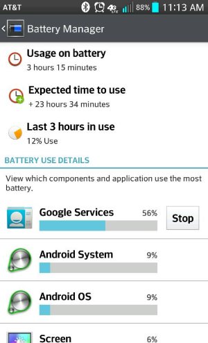

I'm thinking yes. The attached shot is a detail of my Android System, on a recent day where my idle battery drain spiked. My GPS was off the whole time. Yeah there's a bug somewhere, but I still don't know what triggers it.

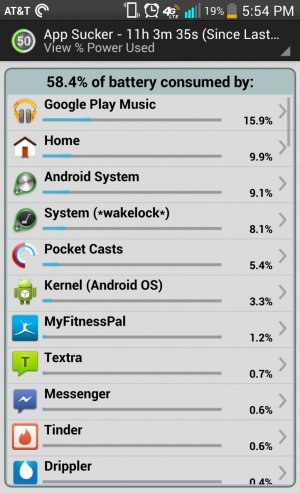

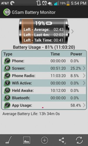

Ok. Check out this screen shot. It was idle all morning with 2 missed calls 3 text 1 voice mail, no screen time. I have all locations on plus history and reporting. GPS, bt, WiFi on. The only thing I changed since last night is Facebook. I only left push notification on. I don't think this is what made the difference. Maybe because I wasn't out and Phone wasn't looking for different signals?

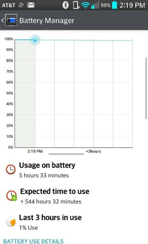

Here is my last 2 days off the charger. This is with over 5 hours of screen on time, and what this battery can do when things are working properly.
