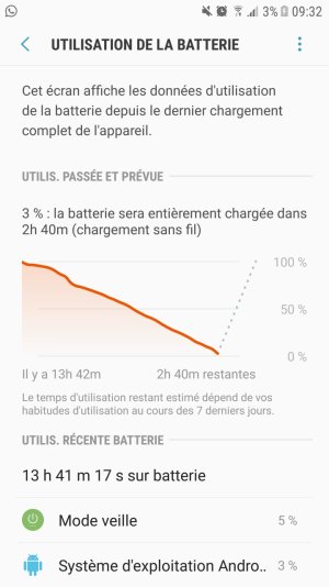

In airplane mode during the night it’s fine, (<5% drop)
With airplane disable, wifi enable, LTE enable:
-during the night it goes from 80% to 4%
-In the battery status screen, if I do the sum of the app consuming battery, it’s 20% and not 96%! (and I think it was when I was using the phone, before going to bed).

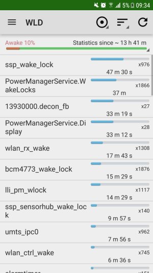

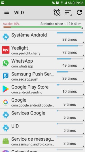

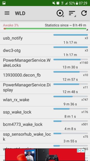

-I installed Wakelock Detector and here are the results. It says it was in deep sleep 11h
Do you have an idea of where the problem can come from please?

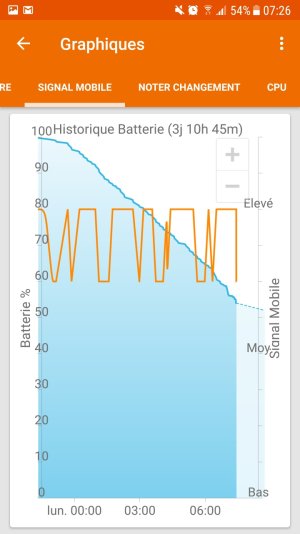

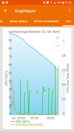

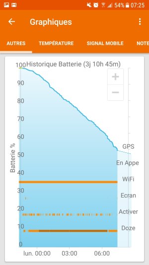

Welcome to Android Central! Can you show us the Cell Signal Strength graph from GSam?
Hello,
Thank you :)
Here are the graph:
CPU was idle and Doze activated. That's strange!
Regards,
Jean-Paul

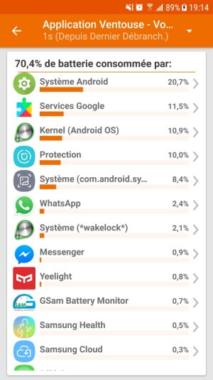

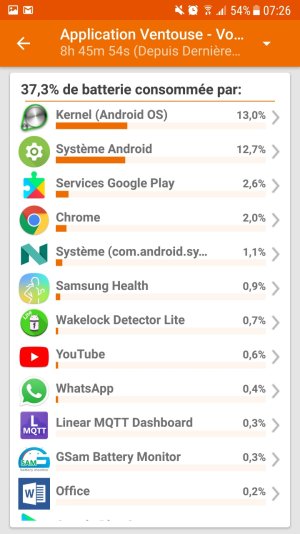

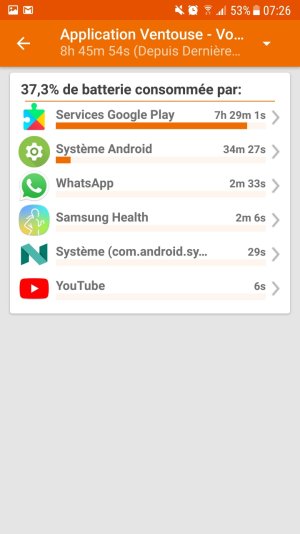

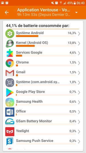

Ok, the cell signal looks fine, so that's not the problem. Can you show the battery stats for which apps are using the most battery? Maybe some app has gone rogue and is persistently trying to refresh data.
Hello,
Here is the screenshot during the day:
I will try to record the same data during the night with wifi + LTE on.
Thank you
I wonder what Protection is doing during the day that is taking up 10% of battery use. I assume that's some system app -- check its settings to see if something about it is accessing the web frequently throughout the day.

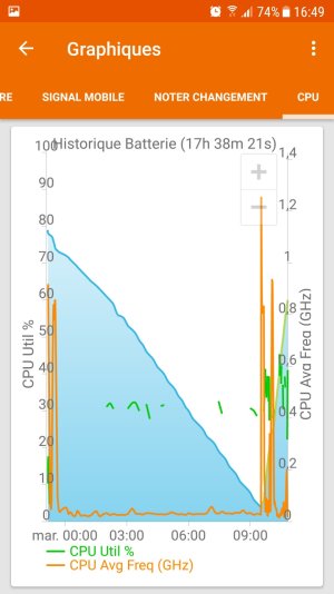

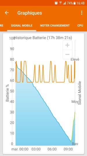

Hello,
I've downloaded the last firmware available for my phone on sammobile (SM-G920F, written on the battery)
But the CSC is different than the orignal.

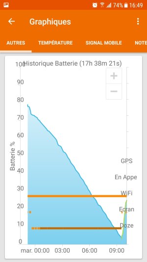

I let it overnight and it losts almost 50%:
I don't know why in the battery menu of Android it says it consums only 5%
The CPU seems to work during the night whereas Doze is activated.
Jean-Paul
