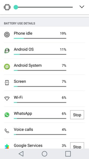

Screenshots of battery usage would help. Please click on the top 3 or 4 battery usage apps (Wi-Fi, Android system, etc) and post those screenshots as well.
Welcome to Android Central! I agree with tourbound129. Charge up to 100%, then let it drain to 20-30% with normal usage, without charging in between. Then show us:
1. The main Settings>Battery screen.
2. The fullscreen battery graph screen (which shows Awake time and Cell Signal Strength).
3. The Screen category (to see total Screen On time).
4. The Cell Standby category, if present (to see Time Without Signal).

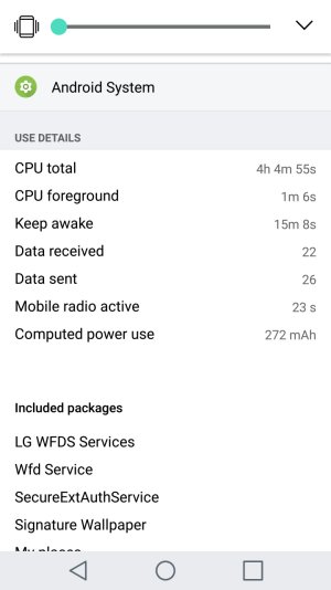

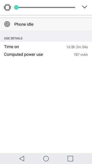

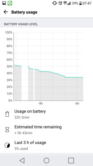

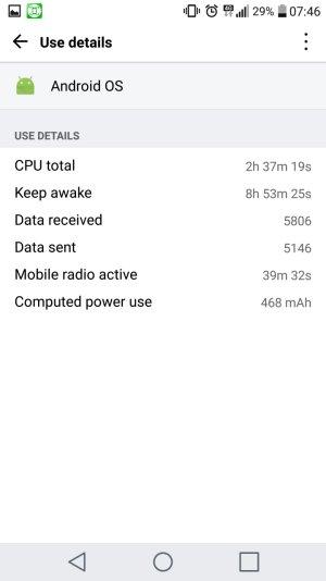

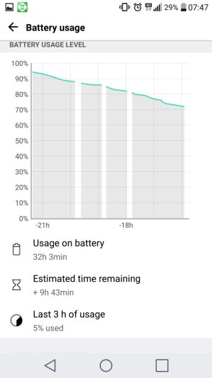

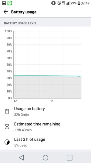

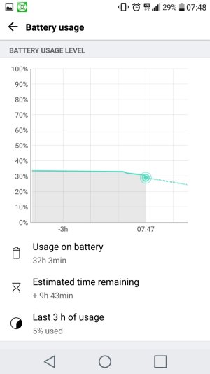

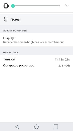

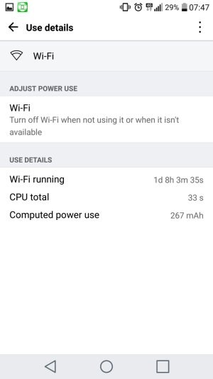

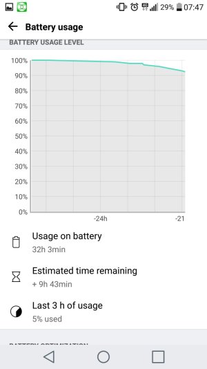

here some screenshots of the battery use. i'll charge now to 100% and download Gsam and post later screenshots from there
the location is turned off too. i dont use almost anything.
thanks for replying! :)

Have you checked for that wi-fi scanning option?
yeah i checked. wifi and location is all off and on Gsam it says 0% on wifi usage but it seems like the phone stay awake even when screen is off according to Gsam
edit:
ohh now i found that bluetooth and wifi scanning while wifi is off was turned on. it can work even when location is off? i'll see how's the battery now and if i have problems i'll write

The reason for the wi-fi scanning is to "Improve Accuracy" (which means that whenever an app asks you if you want to Improve Accuracy and you say yes, it will do this, along with turning on your GPS radio). The phone will use nearby wi-fi networks to improve your location accuracy (I think by using the physical MAC addresses of those routers). It's not supposed to be a significant battery drain, but I think it can be for some people.
thanks alot! now it doesnt show me that wifi usage takes any battery but still idle and android system takes a lot and im on 74% battery now and only 12 minutes SoT so there's still a problem

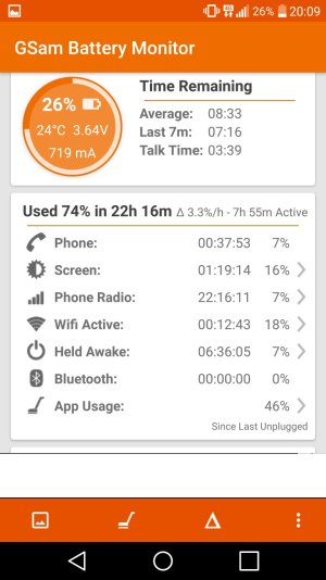

Although the cell signal strength looks fine at the time those screenshots were taken, it'd still be good to see what it's like over the span of a whole battery charge. Look for the screen in Settings>Battery that shows the cell signal strength over time, or install GSam Battery Monitor, which has that graph.

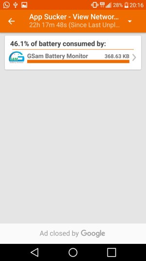

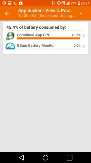

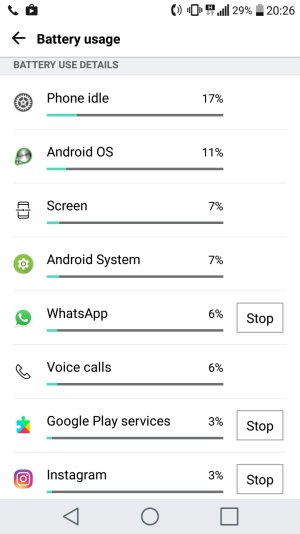

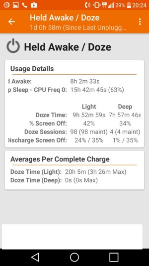

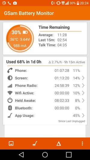

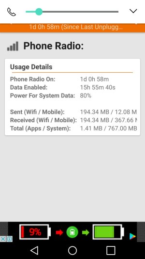

here some screenshots from gsam. i noticed that when i turn off 3G data before i go to sleep and wake up the precent stay the same or i lose only 1% when i sleep (~8 hours) but when i turn 3G data on the battery drain fast.

There should be a graph in GSam that superimposes the cell signal strength over the battery level -- can you show us that?
Do you only have 3G reception, or is there also 4G? If you have 4G, but the phone often only shows 3G, that could suggest weak 4G in your area, which might also contribute to battery drain, as the phone has to keep switching back and forth between 3G and 4G.
I routinely turn off mobile data overnight (since the only thing I need from the phone while I'm sleeping is to receive any emergency calls or texts), so that's one way to reduce overnight drain.
i can't find the graph. do you know where is it? i have 4G here but it switches to H sometimes but on the level bar i have good signal on both of them. the weird thing is that when 3G data turned off i dont have battery drain i think but when 3G data is on i lose a lot no matter if the screen is on or off and as to Gsam it shows that the phone is awake most of the time. you see something wierd with doze information maybe?
When you have GSam open you'll see a icon toward the bottom, to the left of what looks like a vacuum. Click on that, then go to the phone signal and you'll see the graph that B. Diddy is speaking of.
