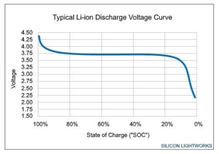

To answer your original question, this is just the nature of Li-ion batteries and how their state of charge is calculated. The voltage curve is mostly flat until you get to the low end of charge level, then it drops like a rock. Once the charge level gets that low, the current draw increases as voltage decreases. Li-ion%20Discharge%20Voltage%20Curve%20Typical.jpeg

Thank you this is what I was looking for, if it was normal behavior as it reaches low level of battery life.
To answer your original question, this is just the nature of Li-ion batteries and how their state of charge is calculated. The voltage curve is mostly flat until you get to the low end of charge level, then it drops like a rock. Once the charge level gets that low, the current draw increases as voltage decreases. View attachment 329463
