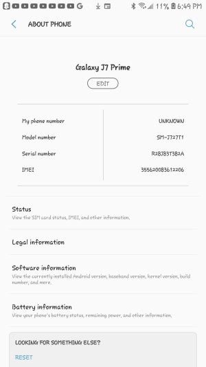

My phone battery is really faulty
You never told us which phone you have. "My samsung phone" is way too vague.
The J7 Prime is really old -- released in 2016, so it's 9 years old. If it's the original battery, it wouldn't be surprising that it's failing. But even if you replaced the battery, there's a good chance that replacement battery is also old and degraded, since it may have been sitting on a shelf for years.
