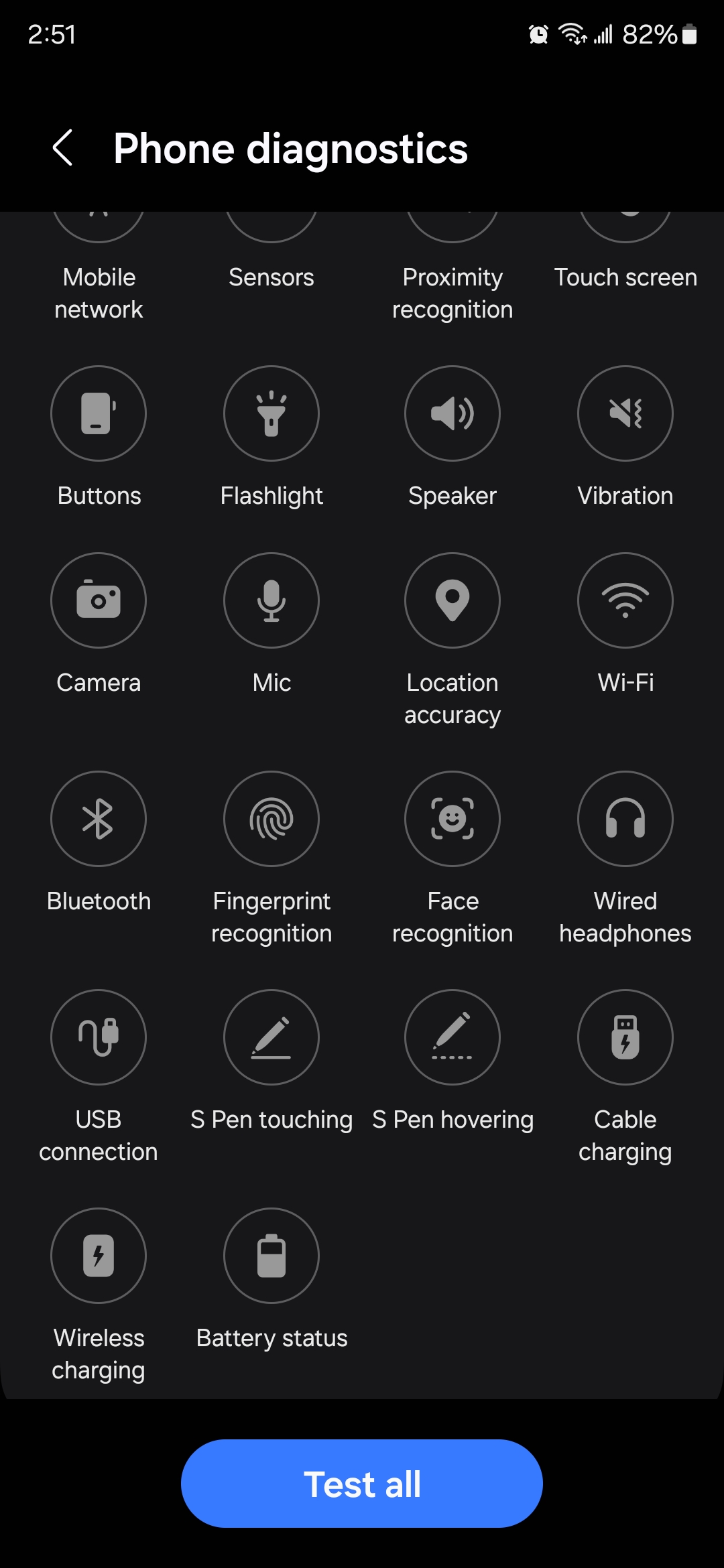

In device care you have Under phone diagnostics to check charging cable and USB connection test so run it see what it says
