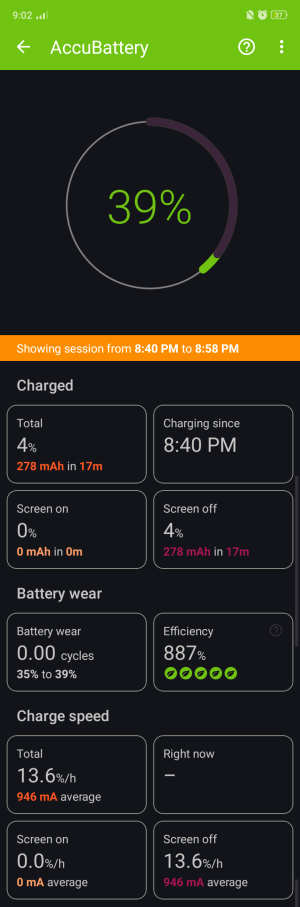

I'm using a charger that can charge up to 3k mA screen off. I leave my phone charging while in screen off (see the picture) and it only gain 4% for very long time. After unplugging and replugging the USB in the adapter (not in the phone then BOOM! 2700+ mA
