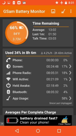

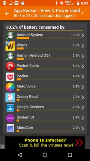

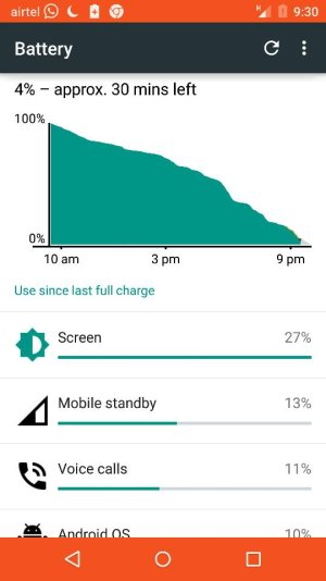

My battery life has taken a complete nosedive in recent days on my Moto X with Lollipop. Not sure what it is. I had less than an hour of screen on time and it was dead in 8 hours. I installed GSam Battery but honestly I dont think that's giving me much insight. App Usage is usually very high so maybe I've got a rogue app installed.
I may just completely wipe the phone and start from scratch.
Here's my battery stats. Any ideas?
I did a full wipe about ten days ago and my battery life is noticeably improved. I was having very high app usage after the update, particularly from the Android system and kernel. I'm glad it got better because I was having to charge at least once and sometimes twice a day to make it through the day after the lollipop update. It was a pain doing the reset but well worth it.
To be honest, 21 hours on battery doesn't seem terrible with the usage you show. What were you getting before 5.0?
The problem is, I was at work for most of that time which means my screen is off for nearly 8 hours straight. I usually never go above an hour screen on time during the day and the phone still struggles.

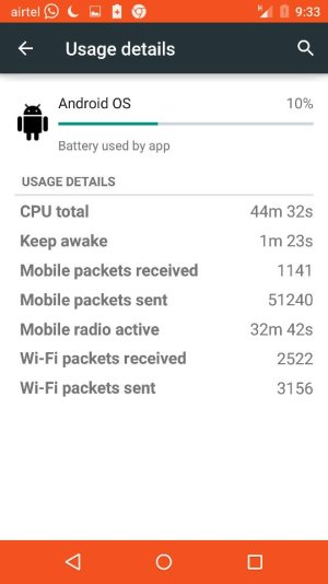

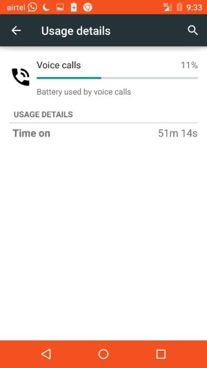

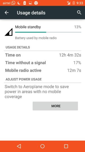

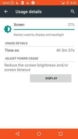

I got my baby 2 days ago (bamboo white). Got lollipop out of the box.
What does this mobile radio active mean...
My gsam app shows different SOT than lollipop battery monitor... how??
