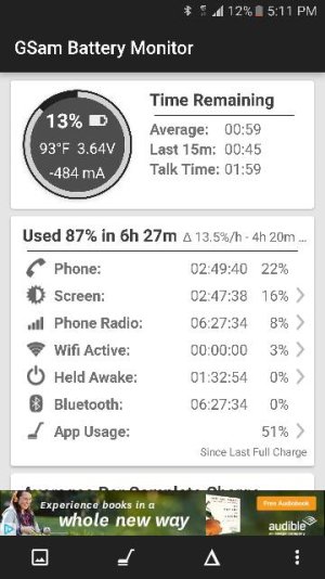

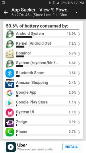

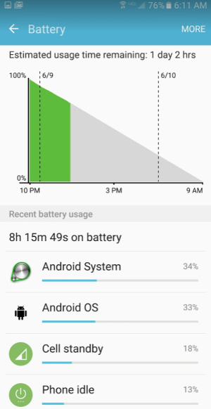

ScotchRocks: something is running all night, as your 25% overnight drain is not even close to normal. On my T-Mobile version, I will lose 3-4% over 7 or 8 hours, and that's with the edge night clock running.
You might try installing the app Better Battery Stats, fully charge the phone, and after a few hours of non-use (like overnight) look at the CPU States show that the phone is mostly in deep sleep. Overnight, it should be about 85% or so in deep sleep, with the rest when the phone wakes up from its Doze mode and the apps sync. When I've had a rogue app running, I can see the phone never going to deep sleep and once you find it, you will see dramatically better stand-by time
It seems that you have a very weak, or even nonexistent, cell signal. This could be one of the causes for the battery drain.
I don't think so. I only get 1 bar where I leave my phone overnight and I lose about 0.4% per hour overnight. It's about 0.8% per hour with AOD enabled. However, I don't have WiFi or Mobile data enabled. From the screenshot posted by ScotchRocks, it looks like WiFi is enabled - perhaps something is continuously trying to sync/update overnight?
