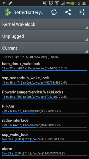

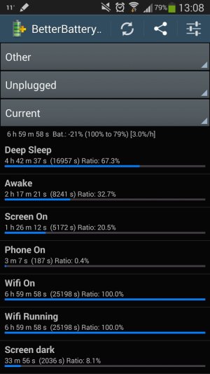

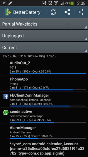

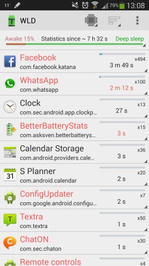

Hi guys,
I'm trying to find out how to improve my battery life
I attached 3 screenshots about my battery life. When I'm using my phone a lot, I seem to get around 5 hr of screen on time.
As you can see from my screenshot, the awake time is quite a bit higher than the screen on time. Can this be considered as normal? How does your screen on time compares to awake time?
Thanks in advance,
Ben

It's normal. You have to think even if the screen isn't on the phone wakes up to do your syncs and other things. It shouldn't always be awake but it doesn't look like it is.
Sent from my T-Mobile Note 3 using AC Forums.
Its normal. I'm charging my phone but as you can see my phone awake time is higher than my screen on time. The more you have updating in the background the worse your battery life will be. I have my phone set to the minimal for auto updates (Google apps update, weatherbug at max of 6 hours). I don't use Facebook so I save battery there.
Sent from my Droid Maxx using Tapatalk Pro
Yes, thanks for your information.
It's nice to see other stats and that it performs quite similarly !
GSAM Battery and Better Battery Stats will give you a better idea of what is waking and holding it awake...
