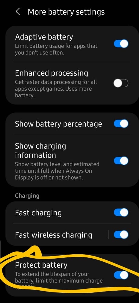

Speaking of battery life, so Samsung now has this Protect Battery feature on the Z Fold³, Z Flip³, and, as I understand it, some of their tablets. This feature has yours truly written all over it as it means a longer lasting device...at least in my book. I feel like all phones should have this and hope to see iOS advance their version as well as Android (as a whole) adopt it. I mean, why not? For now, kudos Samsung.
I will have to look into these things. And that's a nifty little tool on the newer devices. I suppose I can have a new battery put in by ubreakifix if it's recently an issue.
