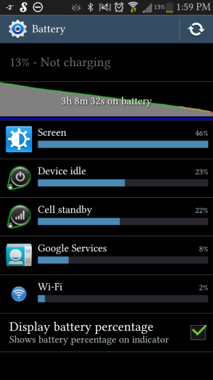

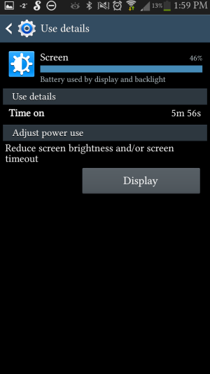

You left out the Screen on detail, which is very important. Need to have all three of those data points in order to make an educated guess about what's going on. If you haven't already started a charge cycle just capture all three items again and repost.
From looking at the History details view it appears that the phone was Awake much more than the Screen on time would account for. You can use something like Wakelock Detector: http://market.android.com/details?id=com.uzumapps.wakelockdetector to see if you can identify what's waking the phone so often.

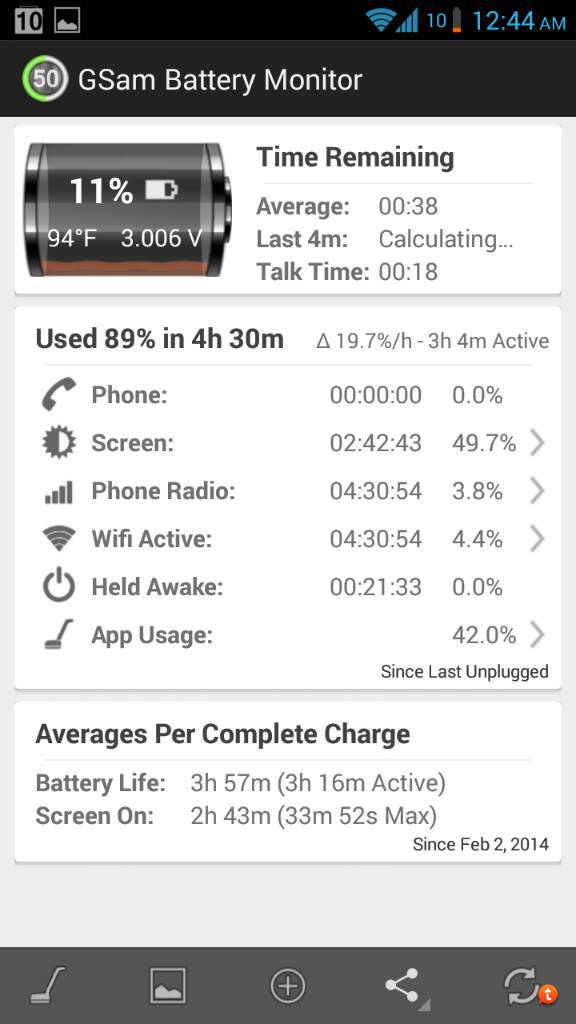

wish my battery lasted that long... today was an absolute joke, must be something wrong with my phone - see pics

There's a very good reason that we ask for all THREE screenshots. Please fully charge the phone, restart it while it's being charged and then let it drop below 30% and capture all three data points.
It looked like you had a pretty marginal cellular signal, so you could also install GSam Battery Monitor Pro: http://market.android.com/details?id=com.gsamlabs.bbm.pro (there's also a free version) before you take the phone off the charger and include the Radio Detail screenshot.
That'll better quantify your cellular signal.

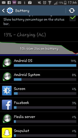

I bought muy S3 about 8 months ago and just recently i noticed my battery has been draining fast 8~ hours. I decided to root it and now I'm running cm 10.2 un bloated (ROMcleaner) but there are still battery issues. Any ideas what's causing this?

This was a great first post! It's obvious that you did some reading and preparation prior to posting.
From 100% -> 50% everything looks pretty normal, but then your battery life falls off a cliff. If I didn't know better I'd say that something is wrong with the battery, but it shouldn't have gone bad in just eight months. It's possible, though, so you may want to check with your local carrier store and see if they'll give you a replacement, or pick one up online.
What brightness level do you have your screen set at? Since you have a great cellular signal, and were likely on Wi-Fi much of the time, the screen might be the biggest power hog remaining.
