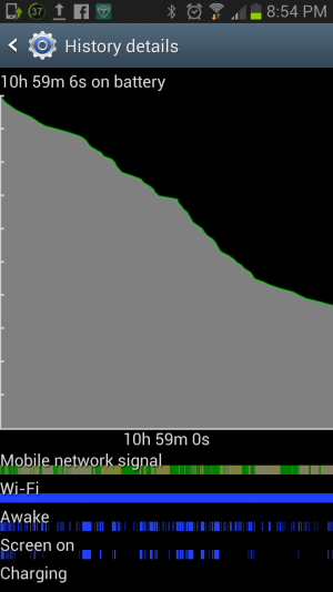

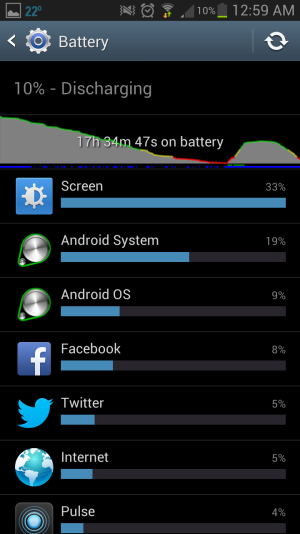

So I'm sure you've seen this kind of thread a billion and a half times but unfortunately the bad news keeps on going. Anyways my battery would not last more than 10 hours on a single charge. Yes I've done the usual battery saving settings like disable wifi, bluetooth, and GPS when not in use. Also my screen brightness is down to 30% along with Battery Saving Mode on (CPU and Screen saving options checked), all Syncing set to 2 hours and weather refresh set to 1 hour. And im also running stock 4.1.2. So idk Wtf is up with this stupid phone but since I bought this phone along with my second and third replacements, they've all had battery issues. I'm getting sick and tired of not being able to get through the day with one charge. I unplug at 6am and it's dead by 4pm with minimal usage. Here are my actual stats. And today it managed to die with a full charge and a half way recharge all within 17 hours. This is not the kind of battery life experience I was expecting from Samsungs flagship phones and especially since this is my first Android phone. I feel like giving this phone one more chance and replacing it. Hopefully this time it works as I do not plan to upgrade till the S5 comes out. But before all that, I'm hoping someone could solve my mysterious battery drain delema while also using the Battery Stats plus app which it did not report any battery drain issues. And as you can see from the screenshots below it went through a full charge and a half within 17 hours. I know, I can't believe it either. Not very happy so far.
**WARNING** USAGE STATS MAYBE SHOCKING TO THOSE EXPERIENCING GOOD BATTERY LIFE. YOU HAVE BEEN WARNED SO VIEW AT YOUR OWN RISK!

It's always a mistake to recharge the phone before capturing the screenshots - makes it difficult to tell what really happened.
Based on the estimates that I had to make due to the additional charge cycle, I don't see anything out-of-the-ordinary. If you really expect longer battery life you can either try something like http://www.amazon.com/gp/aw/d/B00AK...ag=hawk-future-20&ascsubtag=UUacUvbUpU3030258 or get an iPhone.

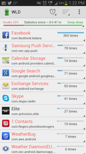

If you haven't already, try installing Wake Lock Detector to see if anything is causing the phone to wake up too frequently.
Your screen-on time of 4 hrs 6 min, although not great by any means, isn't ridiculously abnormal. As a comparison, my original Razr Maxx (with the mammoth battery) gives me a total screen-on time of 5-6 hours with mixed real-world use.
I get about 12 hours of use, and maybe 3 hours of screen time. I would love to get what you are getting.
Thanks for suggesting that app to me, it's very informative and according to it, com.facebook.katana is what keeps waking up my phone. What is it and is there any way to remove it?

It's Facebook: https://forums.androidcentral.com/e...details?id=com.facebook.katana&token=NrEafpAF - it doesn't even rate a 4.0 in the Google Play Store; I would recommend ditching that sooner rather than later.
Edit: and as Golfdriver noted, anything around 12-15 hours of total time, with ~3 hours of screen on time, leaving you around 15% of battery remaining, is considered good for this phone.
