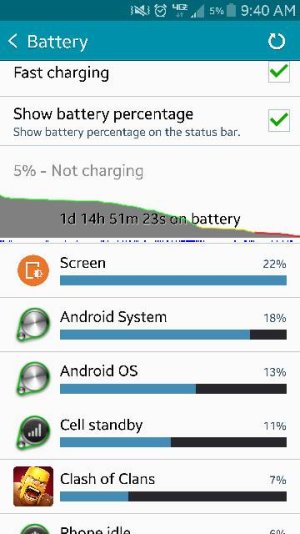

I use S Health and battery life is still great. I also use battery hogs like Clash of Clans and Plants vs. Zombies 2. I think what works for me is restarting the phone once the battery gets around 5%. I use the battery charging kit so I just swap batteries and keep it moving. These things are like computers. You're not suppose to leave them on 24/7. Over a day and a half with each battery!
That's funny. It's like a computer, which is why I never turn mine off. With the exception of a few power outages and vacations, my desktop computer has been on 24x7 for years in a row.
I guess that is funny...I'm laughing with my phone lasting almost two days on one battery. Hope your LeaveItOn24/7 method is working for your Note 4.

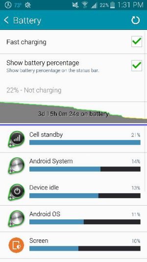

Has to be your phone. Take a look at my battery and this is with moderate use. Surfed a little on the net, watched a few vids on YouTube, even drew a pic or two on my S note. Plus texting and checking email.
